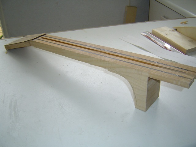

PostPosted: Sat Jan 06, 2007 9:12 am
Bob,
Do you mean like this?
PostPosted: Sat Jan 06, 2007 9:35 am
Todd I float my fB as well using an extension of the neck, the extension is a continuation of the neck wood not an addition. I do run the carbon rods through it as well, they go the full length from the head. This gives a very stiff stable neck right through.
Colin S39088.7339814815

Looks good, Colin. My neck extension supporting the fretboard tongue will also be a continuation of the neck wood, not an addition. In my case, with the fretboard elevated, the neck extension will be the full width of the fretboard and fully visible from the side view once the neck is bolted on. The top will not be cut out to receive the neck extension, as I assume it is on yours.

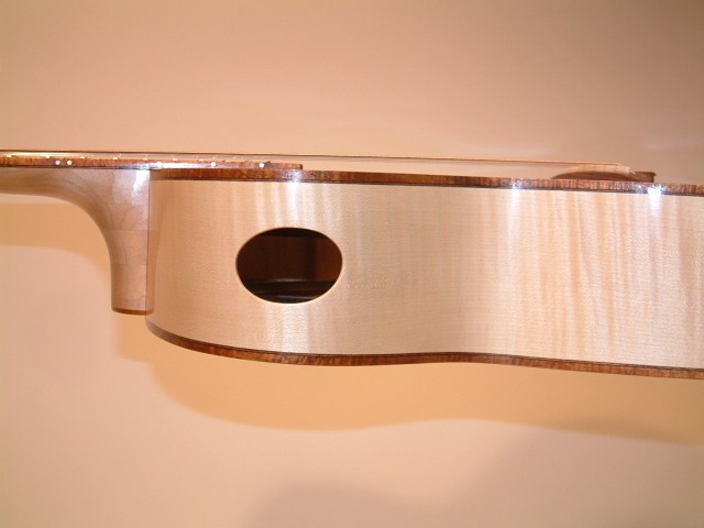

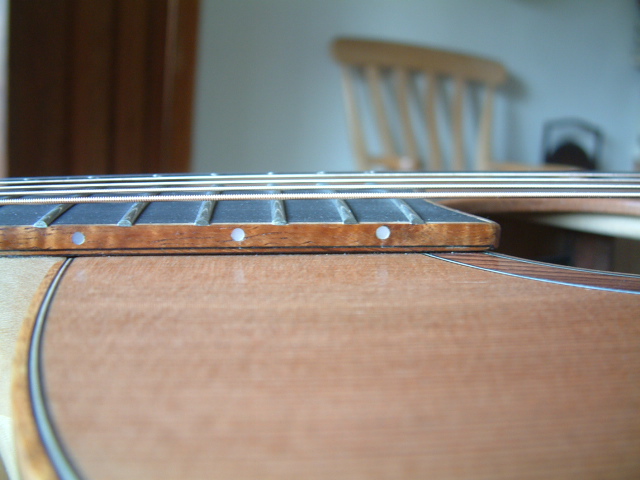

Anybody got a sideview pic of a fully assembled floating neck (on the body)?
PostPosted: Wed Jan 10, 2007 3:52 am
[QUOTE=slackkeymike] Anybody got a sideview pic of a fully assembled floating neck (on the body)?
Mike[/QUOTE]
Yes,
Dave White39092.4958333333

Thats your Samhain model...went to your site. Very nice! Being an engineer, I am curious how that "canilever" stays off the body. But then again, playing that high up should not result in a lot of force (towards the body). Is there a noticable difference in sound? (whats that hole in the side?)

PostPosted: Wed Jan 10, 2007 9:53 pm
[QUOTE=slackkeymike] Thats your Samhain model...went to your site. Very nice! Being an engineer, I am curious how that "canilever" stays off the body. But then again, playing that high up should not result in a lot of force (towards the body). Is there a noticable difference in sound? (whats that hole in the side?)
Mike[/QUOTE]
Mike,
Yes that's Samhain. It's not technically a cantilever I don't think - just floating. I got the idea from Colin. The fingerboard extension is an integral part of the neck for almost all of it's length. I also etend the CF rods up there like Colin does. I do think this extra support helps with the notes sustain played up there. Also the dreaded "hump" is not an issue and you can merrily fret with the neck off the body.
The fingerboard extension stays off the body due to it's rigidity and the geometry of the top's upper bout. The gap is tiny as you can see in the picture. I use this arrangement both with and without my adjustable neck system. I plan to use a butt joint adjustable neck system rather than the M&T one shown here to lighten up even more the upper bout bracing and neck block. I really do believe that the upper bout plays an important - albeit subtle - part in the tops ability to produce the best sound.
I photo documented madjustable neck joint here on my website. The hole is a soundport.Dave White39093.2471990741

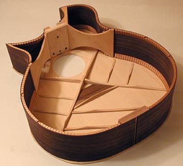

Does anyone have pics of how neck tongue assembly is constructed and pictures of how the neck assembly is re-enfored?-does add'l bracing extend into the box?

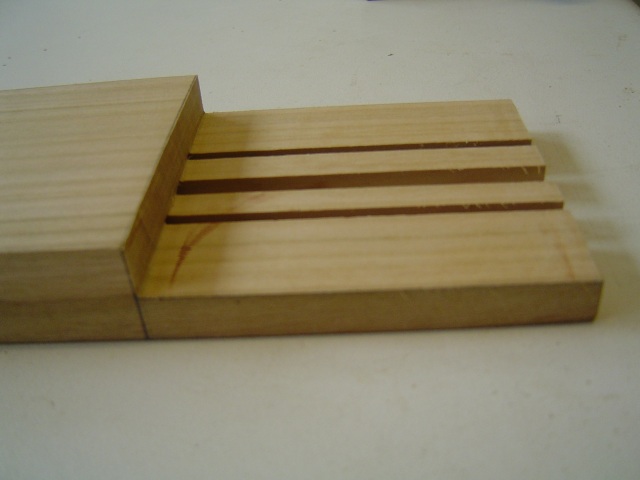

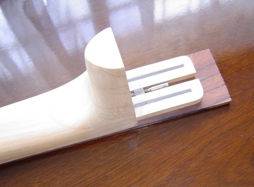

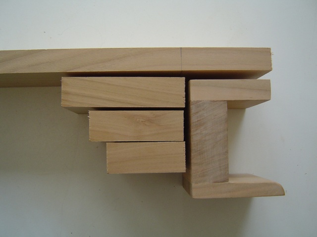

PostPosted: Thu Jan 11, 2007 9:38 am
Bob, I'm not sure what you mean exactly, but this is how I build my necks.
The components are cut to size, the first thing I make on any guitar is the neck block, this is the heart of the guitar and the bit that everything else connects to.
After the truss rod and CF slots are cut on the table router, the neck extension is defined by sawing at the body join point and removing wood with the Wagner.
Then the stacked heel is glued up and attched to the neck (the stacked heel and cut on the neck are cut at 1.5 deg angle) The neck is then roughly bandsawn to profile and the CF rods epoxied in place.
I then get to work with the Japanese saw file and shape the neck. I never use templates for this I like to remove wood until it feels right. The neck extension is slimmed down. Final shaping etc takes place when the neck has been fitted to the box.
As you can see I don't use a mortice, just butt joint, works for me.
When the neck is going to be fitted to the body I rout a pocket for the neck extension in the top and the neck block.
ColinColin S39093.7364583333

That is an elegant system Colin. Do you put inserts in the heel, and screw the bolts into the inserts, or do you put lag screws in the heel and run that into the guitar's interior the way Collings does their neck?
It also looks like you capped off the end of the fretboard extension block with a little extra wood against the graphite rod. Very tidy.
I do something similar to what you have here. But I have been bolting down the FBE block to the internal block so that the FBE is not free floating. The next step is to eliminate that block entirely, let the FBE block float in a pocket in the top and allowing the upper bout to vibrate freely....maybe

Thanks John, yes I just use the inserts in the heel, and bolts as normal.
I do like to fill the slots in the extension against the carbon rods, it does make it tidy. I know nobody will ever see them once it's all put together, but I'll know they're there.
This neck is in cherry by the way, and is my last scarf jointed neck (probably), over to V-joints now.

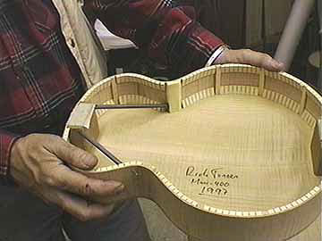

PostPosted: Fri Jan 12, 2007 3:30 pm
Posts: 2687
[QUOTE=bob J] Does anyone have pics of how neck tongue assembly is constructed and pictures of how the neck assembly is re-enfored?-does add'l bracing extend into the box?[/QUOTE]
Bob, if this is what you're asking about, here's two photos (I sure hope I'm not doing the wrong thing by copying these here, but both of these guys have freely and publicly shared these photos, so I'm pretty sure it's okay; my sincere apologies if I'm mistaken). The first is how Mike Doolin supports his neck block, and the second is a method Rick Turner has used.
From a structural standpoint, I would not decouple the fretboard tongue from the top and the underlying bracing without adding something structurally to the neck block/upper bout, as these guys have done, to keep this vital structural area from collapsing over time.
